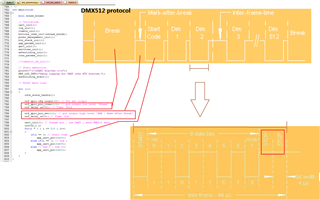

I am trying to do DMX512 (protocol), I hope to help me, time is very urgent
DMX512 protocol is USITT(United States Institute for Theater Technology)Prescribed agreement
I want to follow this agreement to design
============ DMX512 protocol:
Baud:250K
Break:88us
MAB:8us
============ Data frame contains:
Start:1 bit
Data:8 bit
Stop:2 bit
Parity:None
I know that this design will still have errors.
I hope to give me some help, the project is urgent, thanks
Another stop bit need 2 bit, is it necessary to operate directly with registers?
(But the SDK is full of library operations?)

    The potential problem areas seem to be in the initial "break", and the "mark after break". Possibly also the "inter-frame time".
    The OP's code did that with inline delays - that is likely to get disrupted by the BLE stack ...
