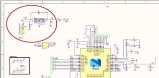

  1. I have custom board with nrf52832. I have lion batery and 3.3V ldo for powering device. I attached shematic.
  2. For preventing lion battery decreasing below 3V, i used a 3.1V voltage detector ic. This detector (STM1061N31WX6F) makes LDO enable pin logic low so everything stops. Here i have 1Mohm pullup resisor.
  3. Detector ic disable ldo 3.1V and re eanble 3.3V. If i load bottloader code detector ic still working same but nrf52832 hangs. Everything is fine without adding bootloader code.
  4. I dont have problem loading apk over mobile with dfu, its ok.
  5. I have 50 circuits for preproduction. I have 50 product.
  6. When i  load softdevice and load "bootloader_secure_ble". I can see DFU_Targ with mobile but when i click no service appear.
  7. When i rise batery voltage starts working, I can see services. But this happen with different batery voltages with different products.  One 4V, another 3.8V, another 4.3V.  But start to see 3.3V ldo output with battery voltage 3.3V.
  8. I short pullup resistor of LDO enable, load apk over mobile device and leave shorting pullup (1Mohms), device hangs. Nothing advertise.
  9. My apk is modified "ble_app_uart ". I add pwm, adc, low power mode and some other things. They all fine.
Its something very strange but i cant find what differs with starting device with "ble_app_uart " or with "bootloader_secure_ble".
Is there any difference for Power on Reset of DC DC conveter or do you have any idea.

    Not sure if I understand, but can you make a trace of VDD when you experience the problem? I want to see voltage level of VDD and for instance fall and rise times, and when nRF52 stops.
    Do you have any serial interface active here? For instance UART, TWI or similar that may be toggling when VDD changes? Maybe there is a problem with the flow control pins and/or uart framing error?

  • Hello Kenneth
    Im having trouble when device start with bootloader area. Im using "bootloader_secure_ble" example. Im also having trouble without any apk loaded. Only sorftdeivce and bootcode. DFU_Targ appear without services when clicked.
    When i erase bootloader area, and load my code after softdevice, there is no problem. Everything works fine.
    Voltage level 3.29V
    Monday, i will try to view with oscilloscope.
    I dont have uart, twi or any other but i have pwm controlling transistors, An ADC input.
    Thanks
    Ferhat
  • Can you check if the bootloader have any output pins that you make sure don't interfere with your hardware setup.
    Kenneth
  • I already checked.
    I can toggle pins with "bootloader_secure_ble" main.c     You can see code block below.
    Pin 14 ligth my blink Led. And its ligthing.
    Pin 16 DFU starting button. I tried jump apk at start by pushing button but coulndt.

  • I am not sure what the problem is here. There is nothing in the nRF52832 that prevent it to work at 1.8V, 2.5V, 3.3V or other voltage within the operating conditions for that matter. If you have UART or similar connected, then it may be that you are feeding supply voltage through a input GPIO (e.g. RTS or RXD pins), if the input pin exceed VDD. Not sure if that is the case here, but something you may try to check. Does you application work on a devkit?
