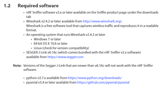

I am just following the steps from the guide for the "Just works" case scenario and repeting the pairing process every time. I am using Wireshark 1.12.1 and the device is running BLE 4.0:
1.Start the Sniffer if not already running.
2. Press w to run Wireshark if it’s not already running.
3. In the Sniffer program, choose the device from the device list.
4. Initiate pairing between the devices if it does not happen automatically. The Sniffer will automatically decrypt encrypted packets.
