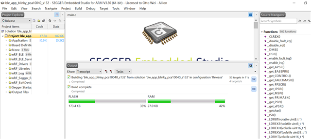

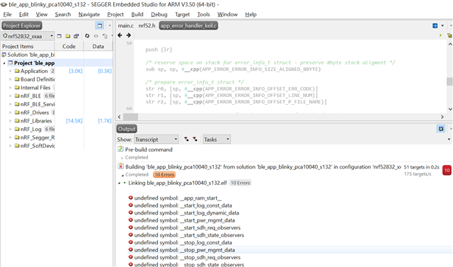

7. Link errors: Linking ble_app_blinky_pca10040_s132.elf - undefined symbol: __app_ram_start__  ....
As following figure shows
