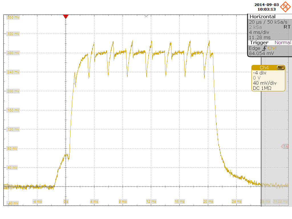

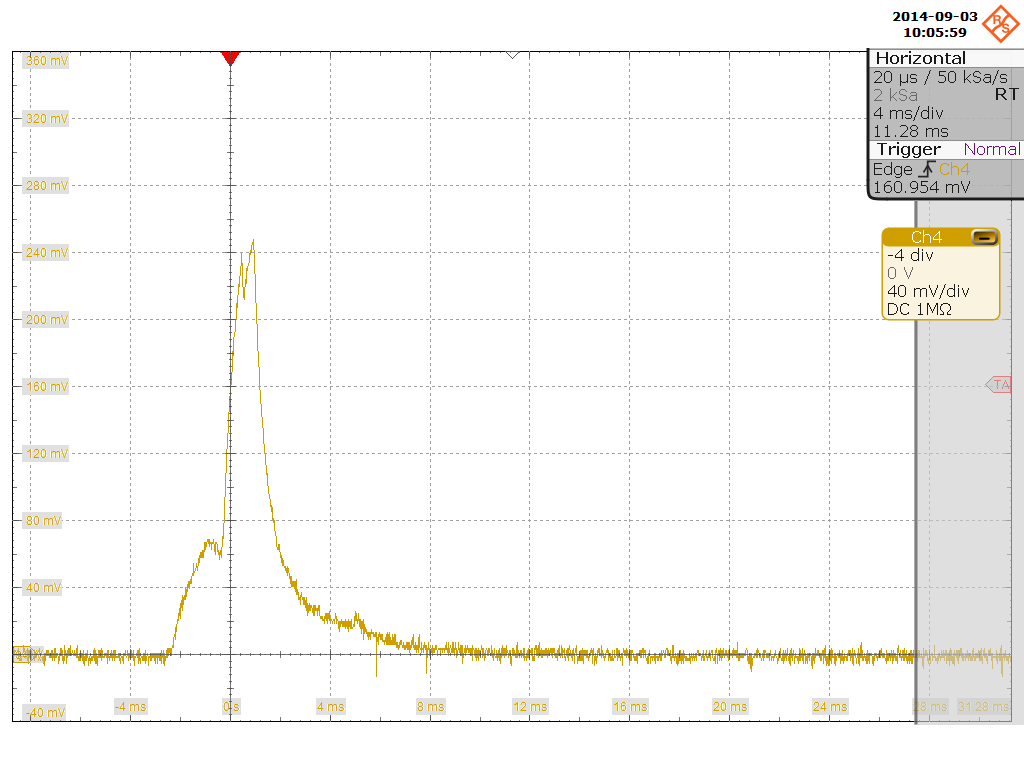

in the best case we got this (no retransmission; R_shunt=20Ohm): image description
and in the worst case this (7 retransmission; R_shunt=20Ohm; peak->15mA): image description

  2. I must reduce the burst current, because of a large voltage drop in the power supply. So I want to stabilize the power supply with a capacitor. But if I want to reduce the voltage drop to 100mV with a average worst case peak current from 15mA for 20ms (worst case) I have to add a 3mF capacitor which is to large for my application. So I try to get a short idle-time between the retransmission peaks to recharge the capacitor. If we do so we only got 3ms to stabilize the supply voltage and then we only need a 450nF capacitor which is much smaller. So is there a way to reduce the current between the retransmissions? Or if you have a better solution I would also be happy:)

    When you're sending data just once in a while, like 1 time per second or every minute, the gazell protocol will not be able to keep sync properly and you will get re-transmits due to the device trying to "hit" the hosts listening channel.
    7 re-transmits sounds normal in such a scenario, depending on what the channel tab size you're using.
    To reduce this, try reducing the channel tab size to for instance 3 channels on device and host.
    You can get caps in a very small package (0402) in the low micro-farad range. We recommend not having more than 100 mV drop on VDD, so you're on the right track.
    Cheers, Håkon
  • "To reduce this, try reducing the channel tab size to for instance 3 channels on device and host." Thats it. Thank you, now i have only 4ms burst current:)
