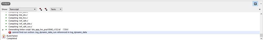

What is the PCA number for a nRF52810 chip? The options for blinky (and other examples) include PCA10040, 10040e, 10056, and 10059. I firstly want to make sure I'm choosing the right one.
Secondly:
When I choose PCA10040 (just as a guess), load it into SES, I cannot get it to even build. I get the error:
"Cannot find run section .log_dynamic_data_run referenced in log_dynamic_data"
Could anyone please help? I'm new to SES and Nordic parts. One thing to note: I'm programming a custom PCB with the nRF52810 on it - not a development kit. However, I'm not even programming anything yet - I just can't even get a blinky example to build, so I'm guessing I'm doing something simple wrong.
Thanks!
Also a sub-question: in Options > Debug > Debugger > Target Device, should I choose nRF52810_xxAA when programming my PCB? Is there anywhere else in options/settings I need to specify what chip is being programmed? Thanks.
