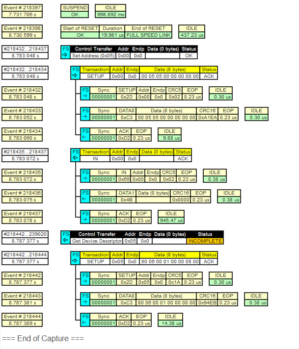

The problem comes when I quit JLinkExe (regardless of leaving the J-Link Pro connected to the target):
When I quit JLinkExe, my Mac and the target continue to be able to communicate over USB, however if I disconnect the USB cable, and reconnect, I can not get the device to re-enumerate no matter how many times I unplug and re-plug the cable.
If I relaunch JLinkExe, and type "connect", I immediately see my custom board enumerating on the Mac.

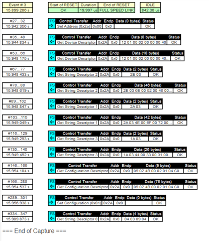

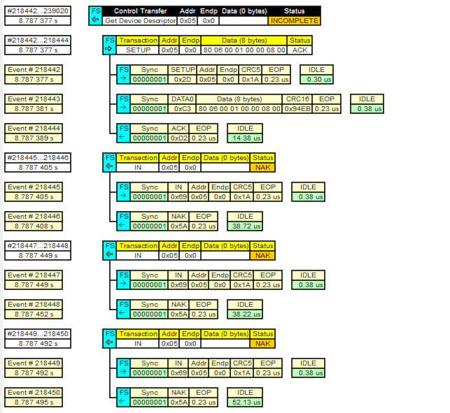

    The device answers some of the USB transactions, so it could be some timing issues with your application.
    Do you see the same behavior if you test the unmodified usbd_cdc_acm example in SDK 15.1?

    So, as it turns out I do not see these issues with the usbc_cdc_acm example in SDK 15.1. I am able to successfully plug/un-plug the USB cable (through a hub, without a hub, through two hubs) and the Mac enumerates my custom board as a /dev/tty.usbmodem**** regardless of if JLinkExe is connected or not. Yay, it's not the hardware!
    Next, I tried the usbd_ble_uart sample with the same (working) results. Hub or no hub, JLinkExe or not, it works! Also, shedding further light onto the issue, the USB enumeration is *instant*. In the best case scenario with my app, the enumeration takes maybe two seconds, worst case (no hub, no JLinkExe) it takes like 7 seconds.
    My app is refreshing an OLED screen via ~8MHz SPI on a timer interrupt. When I boosted the priority of the USBD above the SPI (i.e. to a lower number than the SPI code) everything started working reliably.
    Sigh :)
    Thanks for the advice!
