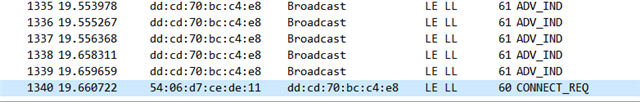

We have a custom board with a Telit Bluetooth module, Bluemod+s42, now.
At present, I am using the "nRF Mesh" APP to test the feature of proxy. But, I encountered an issue that a same project is able to run on PCA10040 and not on my custom board. It also shows an error code "app_error_weak.c,   95, Mesh assert at 0x00028E6C (:0)" on the log.

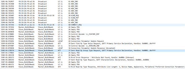

I also utilize the sniffer to observe the package between APP and device. In the following two pictures, the failed provisioning process was ceased when CONNECT_REQ event was occurred.
The log of successfully provisioning
The log of failed provisioning
    It seems that the connect request was not received by the peripheral or the central didn't continue after the connect request. Which phone did you use for provisioning ?
    Which softdevice did you use ?
    I assume you have the 32kHz crystal on the module.
    I would suggest you to make sure BLE and the radio works fine before testing with mesh. Please try to test with any ble example in the nRF5 SDK v15.
