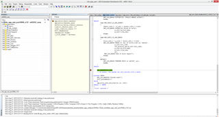

I'm using nRF52832 with SDK 15.0.0 base on ble_app_uart example. But I meet a very strange problem. The project couldn't run after I program, no matter I use IAR or nRFgo to program. it runs to the NRF_BREAKPOINT_COND when I debug it. What reason would lead to this problem?

  • I suspect the new error you are referring to is due to the timeout of the device after a given amount of time, thus the advertising will stop and the device go to sleep.
     Inside advertising_init(..) in the main file, the following line will set the timeout time (in units of 10 millisecond):
    When the timeout happens, and the advertising stops, a BLE_ADV_EVT_IDLE event will happen. Then the device will be put to sleep, and you wont be able to connect to it.
    You can solve this by setting the APP_ADV_DURATION define equal to a really large number, e.g. 3600 00 (1 hour).
    Best regards, Simon
