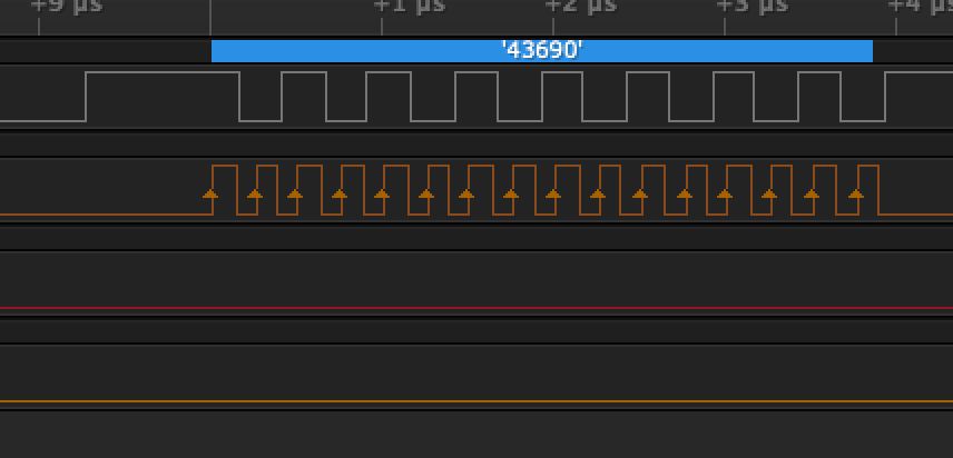

The transfer setup and execution looks like this
static uint8_t data[] = {0xaa, 0xaa};
nrfx_spim_xfer_desc_t xfer_desc = NRFX_SPIM_XFER_TX(data, 2);
// Transfer test 16 bits
nrfx_spim_xfer(&spi, &xfer_desc, 0);
This has to be some weird cocktail of me setting something wrong or initializing something else that interferes with SPIM. Any thoughts are appreciated!
