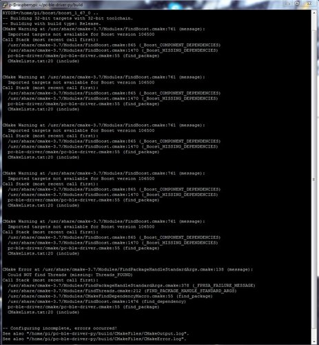

I'm using a nrf52 as pheripheral BLE in embedded system with sensors. I need a ble central to receive the data from the sensors by connecting to the nrf52. I'm trying to use pc-ble-driver-py for my raspberry 3 by following this GITHUB but without success. I've got an error when i'm trying the cmake command in the /pc-ble-driver-py/build/
I've a Raspberry 3 and raspian stretch lite 4.14.62-v7+ (i've made a fresh install). I have list all the command i typed.

- cmake -G "Unix Makefiles" -DCMAKE_BUILD_TYPE=Release -DARCH=x86_32 -DBOOST_LIBRARYDIR=/home/pi/boost/boost_1_67_0 ..
.. And there it is where i get error.
Screenshoot of terminal after cmake command
My guess is that boost library is not linked or something like that but i can't think of a solution. I need help to make it work...
