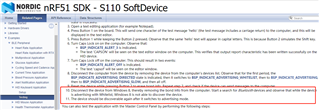

After each delete match at the PC end,None of the broadcasts are searchable。Then I Google the content like this。
I wonder what should be modified。So that it can be normally searched after every delete match

the ble_app_hids_keyboard example uses a whitelist if it has bonded peers. To delete bond information; Reset the device while pressing Button 2 to erase bond info. Documentation available HID Keyboard Application.
