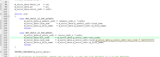

  • Hi Martin,
    Thank you very much for your answer, I follow the debug steps and trace the error code, it seems that the error code number is NRF_ERROR_DATA_SIZE(Invalid Data size), see the below shot, can you point out what's wrong with the data size in my code?  and I attached the zip files which is used for uart1 application.
