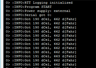

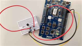

  • Hi Ives.
    I added the full project which I have modified so it now writes out the correct values.
    DS18B20TEST.7z
    I stripped down main.c and added some stuff in the DS18B20.c so it only takes the measurements of the one-wire sensor. (I used RTT for logging)
    (note: 190 = 19.0 C and 662 = 66.2 F)
    which is correct:
