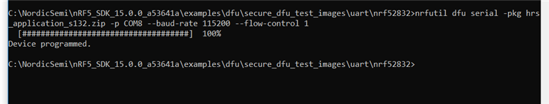

3. Using nrfutil to load the application as in image below:

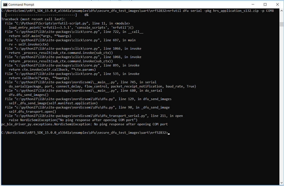

I have reached an impasse. I get an error message as you can see:
pc_ble_driver_py.exceptions.NordicSemiException: No ping response after opening COM port
I have checked the uart with the peripheral demo and this seems to be ok. I have also tried this with the nrf52840 dev kit too and get exactly the same result so I guess my approach is wrong somewhere.
Has anyone experienced similar? Any advice about how to proceed would be appreciated.
