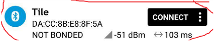

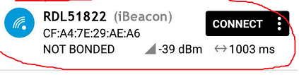

i just start on this project. i just wonder why in phone can scan name and nRF51 can get only mac address for some device.
scan from phone
scan from nRF51
Name: N/A MAC [CF:A4:7E:29:AE:A6]
Name: Tile MAC [DA:CC:8B:E8:8F:5A]
Interesting, it might be that the name is cached somehow in the OS (e.g. have this device been connected as a different device previously during development)?
If you download the nRF Sniffer tool, then you can see the actual content on air to confirm:
https://www.nordicsemi.com/eng/Products/Bluetooth-low-energy/nRF-Sniffer
