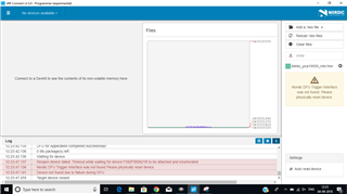

I am using three nRF52840 dongles and have flashed hex file of an nRF example (Ble_Blinky). i want to know whether the hex file is really flashed into the nRF52840 dongle.
I am getting output as: The LD2 led which is built-in on dongle is continuously blinking Red, Green and Blue. So can you tell me whether this is the required output.

    I think I was a little hasty with my last answer. Let me correct myself:
    First of all;
    LD2 blinking Red/Green/Blue is the expected behaviour of the peripheral blinky example, found in sdk_root/examples/peripheral/blinky.
    From the screenshot in your original question, I can see that this is the example you are using due to the blinky_pca_10059_mbr.hex in the programmer app.
    For the ble_app_blinky, found in sdk_root/examples/ble_peripheral/ble_app_blinky, LD2 blinking Red/Green/Blue is not the expected behaviour.
    When programming the ble_app_blinky example to your dongle (Precompiled hex-file can be found in sdk_root/examples/ble_peripheral/ble_app_blinky/hex/ble_app_blinky_pca10059_s140.hex), LD1 should be lit.
    After I flash the ble_app_blinky hex-file file to my dongle I see that LD1 is lit, indicating that it is advertising. I use my smartphone with nRF Connect to scan for the dongle. I can see that it is advertising, and I can connect to it. After connecting I see that LD1 is turned off and LD2 is lit, indicating that it is connected.
    After connecting, I can see the LED Button Service. If I write 0x00/0x01 to the Nordic Blinky LED characteristic, I can see that LD2 is changing color.

  • Trying to recreate this process with the same setup as Nimish. I insert the dongle into the PC USB port and open nRFconnect v2.5.0. I run the Programmer(experimental) and press the reset button on the dongle and LD2 flashes slowly, maybe a Hz, color red. I then compile the project within armgcc as the PCA10059 folder. Within the programmer I select the nRF52840_xxaa.hex for the ble_app_blinky and the programmer places it in the files section with addresses 0x0002C268-0x00026000. When I select the Write all to devkit, LD2 quits flashing, the PC has disconnected the device, but nothing else is occurring. I suspect the bootloader has not jumped to the appropriate address to start the application.   I can insert the device in a powered USB port but nothing is still occurring.
  • That is very strange. I have no problems doing this.
    Are you sure you flashed the correct softdevice as well as the application?
    Joakim
