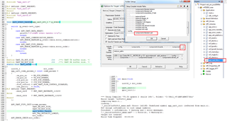

Because there is no UART function in the example, I want to add it.
The picture is everything I added, is it missing something, causing the compilation to fail?
Thanks

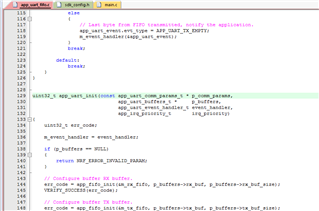

You need to use the UART module API cals, ( APP_UART_FIFO_INIT). Your main.c does not have access to the uart_init function as it is a static function inaccessible outside of its compilation unit(app_uart_fifo.c).
Thank you for your answer.
Previous questioned picture on line 105,
I have the execution function APP_UART_FIFO_INIT
There is no static before the function?
Sorry, my knowledge is not enough. I hope that you can say more details. please.
Sorry I thought the first image was of app_uart_fifi.c.
Anyways, I think you're missing a definition or two in sdk_config.h.
I suggest you compare your sdk_config.h to that of the Serial Port Library Example.
