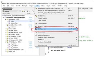

  • I think I have found my resolution.
    When running the unit on the debugger I always use the 'Build and Debug' option which resulted in a working execution whilst it was connected to the debugger (segger Jlink debug output from the NRF52840 board into my target (NRF52840 dongle))..
    If I used the alternative option which was to 'Build and Run' it works initially whilst connected to the JLINK debug interface, but as soon as I do a device reset or disconnect from the dongle it stops the code executing on the target.
    The way that seems to work for me is to use the other option to build the project - 'Rebuild the ble_app_multiperipheral_pca10056_s140' and then use the connect to target and program function
    After doing this the code runs fine on the target dongle and I can cycle the power without any problem / issue of the code not executing.
    Is the Build & run different to the rebuild in terms of compiling levels (e.g. the re-compile/inclusion of the soft device)??
    Cheers
    Michael
  • Hi Michael,
    Great to hear! From the Segger Embedded webpage they explain:
    "When SEGGER Embedded Studio builds your application, it tries to avoid building files that have not changed since they were last built. It does this by comparing the modification dates of the generated files with the modification dates of the dependent files together with the modification dates of the project options that pertain to the build. But if you are copying files, sometimes the modification dates may not be updated when the file is copied—in this instance, it is wise to use the Rebuild command rather than the Build command."
    So if you have copied your project from one of the examples provided in the SDK it seems wise to use the Rebuild command when building your project for the first time.
    -Marjeris
