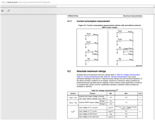

Check out section 6.2 in this www.st.com/.../stm32l476je.pdf
sorry that link didn't work so try typing the link in the screen shot below.
I can't understand.

No, as shown here, the max I/O pin voltage is VDD + 0.3 V. When you have powered the nRF52832 using 2.5V, then the maximum pin voltage is 2.8 V.
The easiest solution is just to run the nRF52832 at 3.0V, but if that is not an option, then might be able to find suitable a bi-directional level shifter that solves this.
