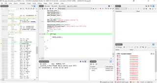

Here is the code snippet. Here I'm just trying to link a BLE WRITE event to a FATFS WRITE function to write a generic string to the file (not sending characteristic data).
However, on debugging, the program execution never seems to enter the fatfs_write() function.
What could be happening? Is there something wrong in the program flow logic? Please help.
