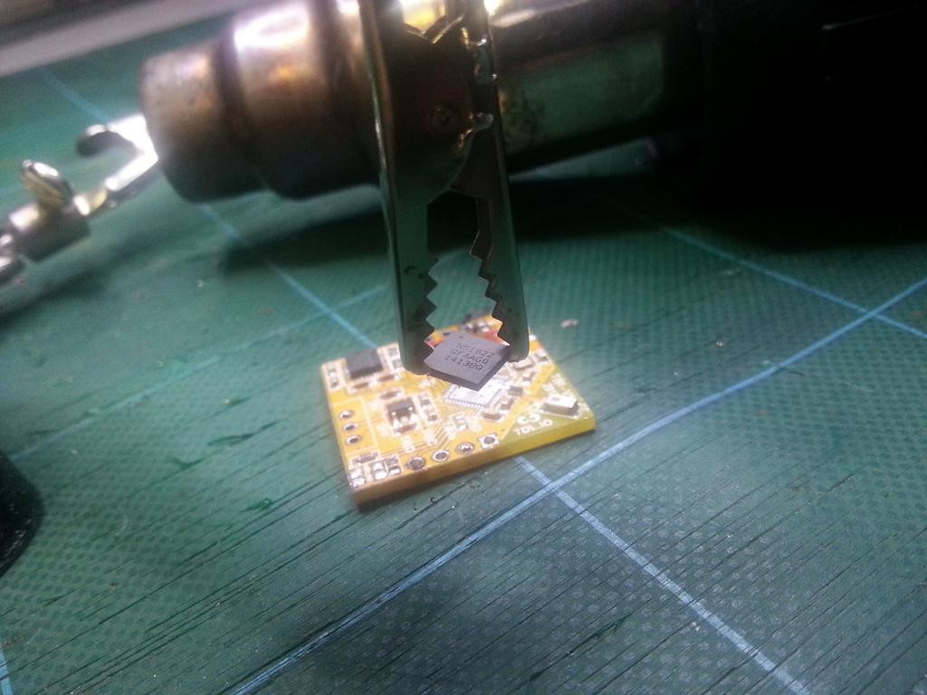

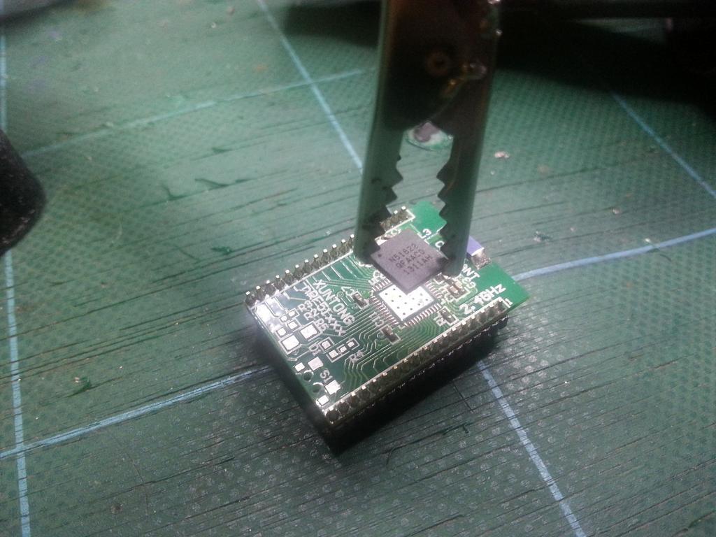

    EDIT: We've been investigating for a few days, and finally found the problem, here are the last steps:
    1. We unsoldered a G0 from a faulty board and placed a C0 instead, it works.
    2. We then did the opposite (soldered the G0 CPU on the C0 board) but it doesn't work.
    3. A few days later, we received a few new G0 from an official dealer and did the exchange:
    http://youtu.be/Jt-F5_ef1pI
    It works, so we can apparently assume that the CPUs of the new batch are faulty. We wonder if it's a common problem, the factory was really serious until now.
    Has anyone had a similar problem ?
    Thanks again so much for your suggestions to all of you !
    Cedric ;)
