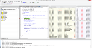

The result variable does not change depending on the input voltage AIN0.
    The only problem I see is that you only have room for one sample in your result buffer, so it is not surprising that you do not get different samples. Try using a large buffer, and update NRF_SAADC->RESULT.MAXCNT accordingly.

    The entire buffer  is full 16380.
    How to make cyclic data transfer ADC -> DMA -> RAM?
  • There is no way to configure a cyclic data transfer in HW like this. The SAADC peripheral will fill up RAM via DMA, but you will get an event when the buffer is filled and have to provide a new buffer and start the process again to continue sampling. (This means that you will have some problems getting an accurate time between the last sample of one series and the first sample of the next series).
