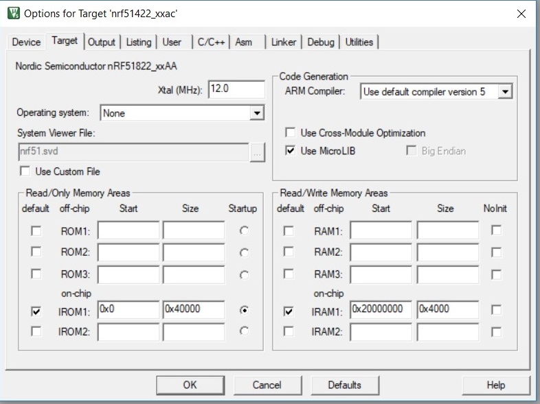

BTW I returned to the SDK examples and tried a few examples that does not utilize any Softdevice , I can recompile them all with either the "n51422" or "n51822" targets but when I hit the Flash button it says "Error Flash download failed- cortex M0" ; in the Error panel it says :
No Algorithm found for: 00000000H - 0000155BH
Everything looks just the same as the other two example that flashes successfully.
Here is the screenshot of the memory parameters
Params
Could you Help?

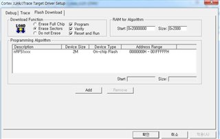

    This indicates that your debugger settings are lacking the flash algorithm for nRF5x devices. This section (debugger options -> flash download tab) should look a bit like this:

    I believe that my debugger certainly supports the algorithm for  nrf5 Processors as I was able to program the Blinky projects plus I double checked what you said and found the settings just like the Photo you attached.
