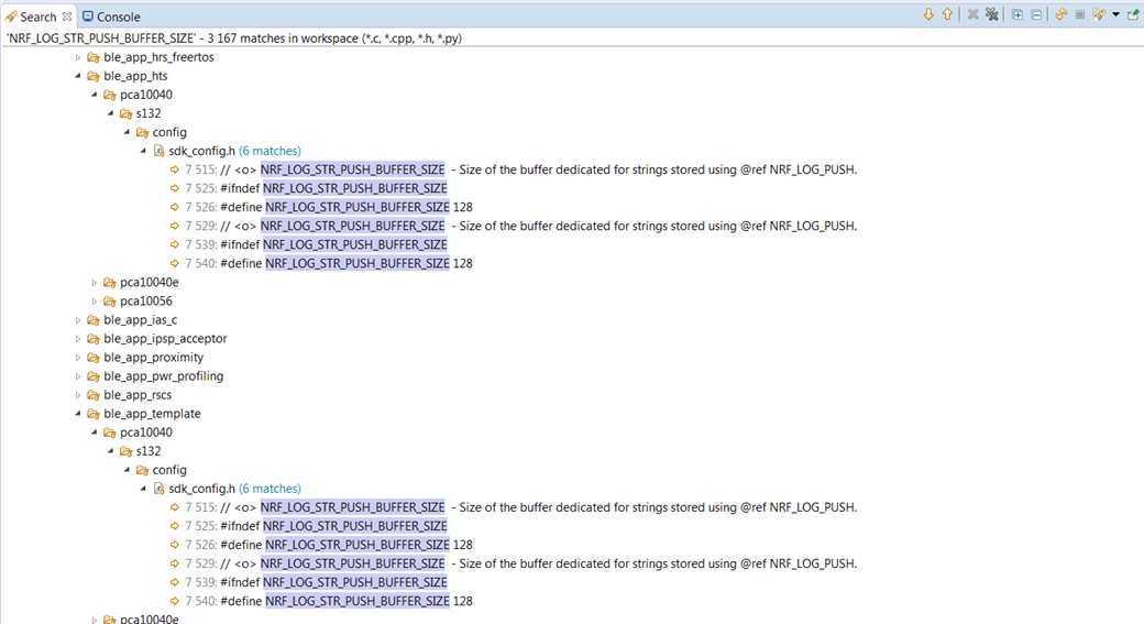

NRF_LOG_STR_PUSH_BUFFER_SIZE defined twice
In SDK 15.1.0 NRF_LOG_STR_PUSH_BUFFER_SIZE is defined twice in every sdk_config.h in the SDK. For example in the ble_app_template/pca10040/s132/config/sdk_config.h:
// <o> NRF_LOG_STR_PUSH_BUFFER_SIZE  - Size of the buffer dedicated for strings stored using @ref NRF_LOG_PUSH.
// <16=> 16
// <32=> 32
// <64=> 64
// <128=> 128
// <256=> 256
// <512=> 512
// <1024=> 1024
#ifndef NRF_LOG_STR_PUSH_BUFFER_SIZE
#define NRF_LOG_STR_PUSH_BUFFER_SIZE 128
// <16=> 16
// <32=> 32
// <64=> 64
// <128=> 128
// <256=> 256
// <512=> 512
// <1024=> 1024
