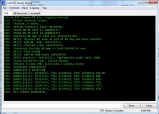

Starting J-Link RTT Viewer found in the Segger Installation folder using:
RTT Viewer starts with the following message in the Log Window:

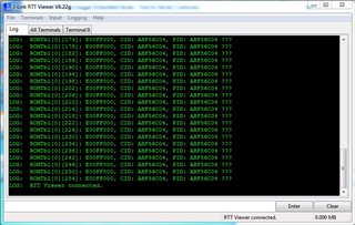

Nothing shows in the All Terminals or Terminal 0 window.
