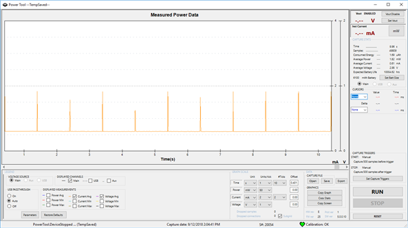

I am assessing the possibility of replacing a low-power MCU in one of our products with an nRF device.
Currently, our low-power MCU spends most of its time in a sleep state, waking up every 10msec briefly to do some I2C comms.
This costs about 1mW on average with this MCU.
I have set-up an nRF52840-DK with external supply for the nRF SoC power, and am measuring (with the Timer SDK example) that the power draw is 2mW. This is too high compared to the other MCU. Is this the expected power draw in system on, idle mode?
I observe 0.08mW in system off mode, but I am unsure if we can even wake up from system off using a timer
