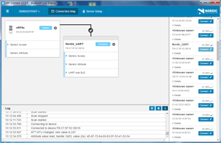

Hello.
I am using the custom board (buttonless) of nRF 52840 to verify the services of DFU and NUS. After firmware rewriting with DFU, I confirmed that BLE communication with the central side board can be done via NUS service.
However, when trying to perform the DFU again, the device name (Norodic_UART) is displayed by nRFConnect, but when connected, DFU can not be done like the following image.
How can I make DFU more than once?
ble_app_button_less has confirmed that it can do DFU more than once.
Central: nRF 52832 (ble_app_uart_c + S132)
Peripheral: nRF 52840 (ble_app_uart + secure_bootloader + S140)
Nordic SDK 15.0.0
    The buttonless DFU example is a template example, it was written in a way that you can start with that example and add the functionality of your application to it. You will therefore need to combine/merge the buttonless example with the NUS example. You can either integrate the buttonless service to your application(NUS) or add your application(NUS) to the buttonless template. In this case, I think it might be easiest to start with the buttonless example, and then add the NUS service to the buttonless example.

  • Is it necessary to set the linker script?
    Yes, after adding NUS to the project, you would need to allocate more RAM to the SoftDevice.
    You would also need to set NRF_SDH_BLE_VS_UUID_COUNT in sdk_config.h to 2.
