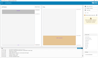

How do I program a nRF52840 Dongle with the thread CoAP example?
I'm trying to program a nRF52840 Dongle with the thread MTD client example by using nRF Connect but I get an error
saying I need to add a SoftDevice. I thought the thread examples didn't need a SoftDevice and when I try to add one
it just overlaps the example's hex file.
Is it even possible to use the thread examples with the nRF52840 Dongle?

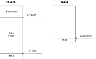

  • Hello Timo,
    You need to update the linker configuration so that the application does not overlap with the pre-programmed bootloader and MBR. If you are unsure how to do this, let me know what toolchain you use and I'll update the answer with instructions.

    The dongles do not have an OB segger so needs to be programmed through USB DFU using nrfutil or the programmer app in nrfconnect.
    I did a quick test with the cli example (nRF5_SDK_for_Thread_and_Zigbee_2.0.0_29775ac\examples\thread\cli\usb\). Below are the changes I made. Same approach should work for the other examples as well.
    --- C:/vidar/workspace/nRF5_SDK_for_Thread_and_Zigbee_2.0.0_29775ac/examples/thread/cli/usb/pca10056/blank/flash_placement.xml	Sun Sep 23 18:48:47 2018
    +++ C:/vidar/workspace/nRF5_SDK_for_Thread_and_Zigbee_2.0.0_29775ac/examples/thread/cli/usb/pca10056/blank/ses/flash_placement.xml	Mon Oct  1 13:40:35 2018
    @@ -38,2 +38,2 @@
    -  <MemorySegment name="ot_flash_data" start="0x000fc000" size="0x4000">
    -    <ProgramSection alignment="4" keep="Yes" load="No" name=".ot_flash_data" address_symbol="__start_ot_flash_data" end_symbol="__stop_ot_flash_data" start = "0x000fc000" size="0x4000" />
    +  <MemorySegment name="ot_flash_data" start="0x000dc000" size="0x4000">
    +    <ProgramSection alignment="4" keep="Yes" load="No" name=".ot_flash_data" address_symbol="__start_ot_flash_data" end_symbol="__stop_ot_flash_data" start = "0x000dc000" size="0x4000" />
    --- C:/vidar/workspace/nRF5_SDK_for_Thread_and_Zigbee_2.0.0_29775ac/examples/thread/cli/usb/pca10056/blank/thread_cli_usb_pca10056.emProject	Sun Sep 23 18:48:47 2018
    +++ C:/vidar/workspace/nRF5_SDK_for_Thread_and_Zigbee_2.0.0_29775ac/examples/thread/cli/usb/pca10056/blank/ses/thread_cli_usb_pca10056.emProject	Mon Oct  1 13:39:25 2018
    @@ -29,2 +29,2 @@
    -      linker_section_placement_macros="FLASH_PH_START=0x0;FLASH_PH_SIZE=0x100000;RAM_PH_START=0x20000000;RAM_PH_SIZE=0x40000;FLASH_START=0x0;FLASH_SIZE=0xfc000;RAM_START=0x20000000;RAM_SIZE=0x40000"
    -      linker_section_placements_segments="FLASH RX 0x0 0x100000;RAM RWX 0x20000000 0x40000;ot_flash_data RX 0x000fc000 0x4000"
    +      linker_section_placement_macros="FLASH_PH_START=0x0;FLASH_PH_SIZE=0x100000;RAM_PH_START=0x20000000;RAM_PH_SIZE=0x40000;FLASH_START=0x1000;FLASH_SIZE=0xdb000;RAM_START=0x20000008;RAM_SIZE=0x3FFF8"
    +      linker_section_placements_segments="FLASH RX 0x0 0x100000;RAM RWX 0x20000000 0x40000;ot_flash_data RX 0x000dc000 0x4000"
    CLI example with modified linker settings:
    thread_cli_usb_pca10056.hex
  • I made the changes to the files in the project you mentioned, changed the preprocessor definition from BOARD_PCA10056 to BOARD_PCA10059 rebuilt the project and then flashed it to the dongle. For some reason it does not work. I tried the hex file you included and it works fine. Is there any other change to the project I missed? I checked the flash layout for both files and I saw that for the App section, yours goes from 0x1000 to 0x47598 and the one I got goes from 0x1000 to 0x475B0
  • Please try the \nRF5_SDK_for_Thread_and_Zigbee_2.0.0_29775ac\examples\thread\cli\usb_bootloader example without modifying anything (ie you can change the board define but is not necessary) . The usb_bootloader variant is configured to run with the pre-programmed bootloader. I was not aware of this when I wrote the previous reply.
