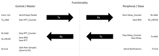

Hi everyone, for the project I'm developing it's extremely important to measure RTT as accurately as possible and as such, after some SoftDevice specification I imagined the following scenario:
Both devices would be connected and through the connection events packets that are exchanged periodically, I would generate interrupts from the SoftDevice upon reaching three specific states. Now, these interrupts would merely start / stop counters, hopefully, not ruining radio synchronization.

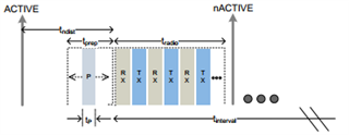

  • When the Softdevice is enabled your access to the Radio peripheral is blocked. Here is a list of blocked and restricted peripherals.
    You can look into using Radio Notifications instead. It allows you to get notified whenever the radio ramps up or down. Here is a (somewhat outdated) tutorial

    So, with PPI I am able to Start / Stop / Clear timers, however, I need to be able to save their value inbetween connection events and mostly, between links, ideally, it should be done when the radio is in the "t_prep" interval, but I'm guessing that access to radio (and CPU) will still be locked.
    If the t_prep takes from 167us to 1542us I could be possible get a interrupt done through SWI solely to run a fast routine that saves the timers value to some data vector.
    So, in order to capture the processing delay on the peer, the radio events that PPI will listen to are:
    • READY - Clear Timer - Radio is ready
    • DEVMATCH - Start Timer - Peer acked packet
    • CRCERROR - Stop Timer (and maybe clear) - Dispose
    • ADDRESS - Stop Timer - Peer is now Tx
    After the ADDRESS event, the timer holds the delay value, however, for a multi link situation (the peer will be connected to 3 centrals simultaneously), the next link will just re-start the timer.
    I am not seeing a good solution for this problem. Radio notifications only occur at the beginning and end of the radio event containing multiple links, not usable.

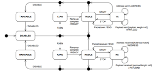

    --- UPDATE ---
    So, upon closer inspection of the radio states diagram.
    I came to the conclusion that using PPI to Start/Stop the timers alone will not work aswell,
    For Central Devices (measuring RTT):
    [DISABLED]
    	-->TXEN
    	[TXRU]
    	READY					PPI: Clear Timer
    	[TXIDLE]
    	-->START
    		[TX]
    			ADDRESS			PPI: Start Timer
    			PAYLOAD
    			END
    	[TXIDLE]
    	-->RXEN
    	[RXRU]
    	[RXIDLE]
    	-->START
    		[RX]
    			DEVMATCH		PPI: Stop Timer
    			PAYLOAD
    			END
    	[RXIDLE]
    	-->DISABLE
    [DISABLED]
    For the Peer Device (measuring Processing Delay):
    [DISABLED]
    	-->RXEN
    	[RXRU]
    	[RXIDLE]
    	-->START
    		[RX]
    			ADDRESS			PPI: Stop Timer
    			DEVMATCH		PPI: Start Timer
    			PAYLOAD
    			END
    	[RXIDLE]
    	-->TXEN
    	[TXRU]
    	[TXIDLE]
    	-->START
    		[TX]
    			PAYLOAD
    			END
    	[TXIDLE]
    	-->DISABLE
    [DISABLED]
    Legend:
    • [ ] - Radio States;
    • --> - Tasks;
    • Simple words - Events that PPI can use.
    Without knowing if the radio is currently in Tx or Rx mode and use Start/Stop accordingly, it just seems impossible.

    Sorry for the late response. Your case fell through the cracks.
    I agree with all your reasoning and conclusions. The nRF5 series simply isn't built for these kinds of things.
    I have one last suggestion though. You can look into using the Timeslot API and some sort of custom radio protocol and PPI/software hybrid. Using the timeslot API you can schedule "sessions" where you are allowed to use the radio at your own discretion between the BLE events. With a custom radio protocol you can work directly with the radio peripheral and have complete control what, when, and where things are being transmitted and received. You are also free to use a combination of software and PPI to time the events. You might find some inspiration in this blog post: https://devzone.nordicsemi.com/b/blog/posts/wireless-timer-synchronization-among-nrf5-devices
