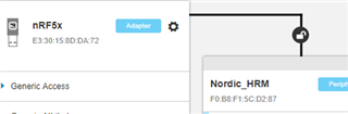

  • Hi Geetha.
    First problem here is that you have used the Wi-FI MAC address. You need to use your Bluetooth address.
    Note also that most smart phones change Bluetooth address roughly every 15 minute.
    I made the following change to your code and ran it successfully:

    As you can see in the code you had not set the address type for the peer_addr pointer.
    I ran this successfully with the use of nRF Connect, where you easy can see your Bluetooth Address, example in the picture below:
    The address I added to my whitelist was:
                peer_addr.addr[5] = 0xE3;
                peer_addr.addr[4] = 0x30;
                peer_addr.addr[3] = 0x15;
                peer_addr.addr[2] = 0x8D;
                peer_addr.addr[1] = 0xDA;
                peer_addr.addr[0] = 0x72;
    As you can se, this is the address i read below nRF5x (E3:30:15:8D:DA:72)
    Hope this helps.
    - Andreas

  • Hi Geetha.
    There are 5 different macros that the peer_addr.addr_type can be set as, you find if you look at the definition of BLE_GAP_ADDR_TYPE_RANDOM_STATIC in SES.
    They are located in ble_gap.h, and are the following:
    /**@defgroup BLE_GAP_ADDR_TYPES GAP Address types
    #define BLE_GAP_ADDR_TYPE_PUBLIC                        0x00 /**< Public (identity) address.*/
    #define BLE_GAP_ADDR_TYPE_RANDOM_STATIC                 0x01 /**< Random static (identity) address. */
    #define BLE_GAP_ADDR_TYPE_RANDOM_PRIVATE_RESOLVABLE     0x02 /**< Random private resolvable address. */
    #define BLE_GAP_ADDR_TYPE_RANDOM_PRIVATE_NON_RESOLVABLE 0x03 /**< Random private non-resolvable address. */
    #define BLE_GAP_ADDR_TYPE_ANONYMOUS                     0x7F /**< An advertiser may advertise without its address.
                                                                      This type of advertising is called anonymous. */
    Note that your phone may have changed its address from the one in the picture you sent, as most phones change Bluetooth address roughly every 15 minutes.
    - Andreas
