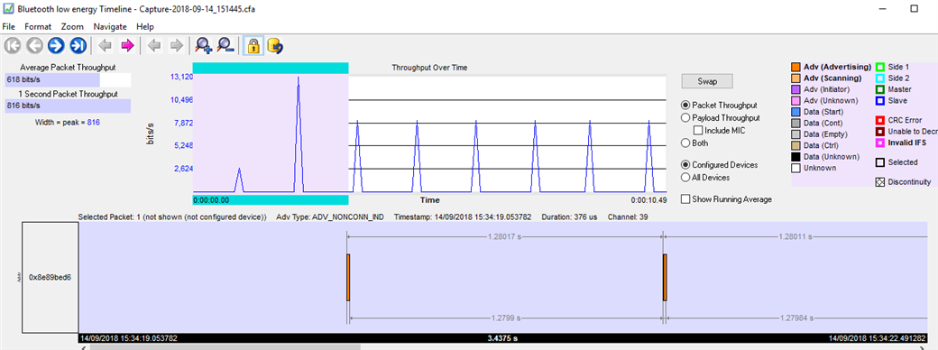

    On the oscilloscope I can see the I/O go up each 500 mS (in advertising),  this means that the micro is not in sleep.
    In the same time with an BPA400 bluetooth protocol analizer I can see the advertising at 1,28 sec:

  • I 'm using a my custom board. But now I have found the problem.
    I had forgotten to remove a timer that I used to update the battery service into  timers_init();
    Now if the device is in advertising I don't see the change in the I/O port.
    Thanks for your patient.
