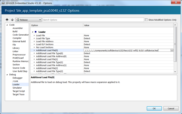

I'm using Segger Embedded Studio with Ubuntu, trying to write a minimal code to let the chip start advertising.
I tried to read and understand the example codes provided in the SDK, but found myself frustrated understanding these Macros, data structures and the SoftDevice handler functions. Now I'm trying another approach to use the SoftDevice directly, I feel more comfortable to understand these Message Sequence Charts and related SoftDevice APIs.
I started a new nRF52832 project from the "New Project" menu of the IDE, included the necessary folders of the SDK, and wrote a very simple code. My target is to get the chip start advertising and that is all. The project get compiled with no error, but the code size it generated is only 1.7kB, apparently the SoftDevice is not included, but I don't now how to fix it, anybody can help?
Here is my code:

I must missed something, maybe some settings in the Segger IDE?
    You can configure Segger Embedded Studio to load the softdevice HEX-file with the project. Please add it to setting "Additional Load File[0]", as shown here:
    Jørgen
  • I would recommend that you use the flash_placement.xml file found in nRF5_SDK_15.x.0_xxxxxxx\config\nrf52832\ses.
    The FLASH and RAM settings in Section Placement Macros should match the softdevice requirements and chip memory sizes. Flash requirements can be found in softdevice migration guide, which also give numbers for minimal RAM requirements. Note that actual RAM requirements is typically higher. Please start with the settings given in one of the existing softdevice projects in the SDK. You might encounter countless issues when starting building your own project, as there is many settings that have been set in the SDK examples. I would really recommend staring with an existing project and remove what you do not need. This is the approach most customer take, to avoid having to deal with all the project configurations.
