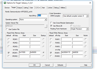

hi
i downloaded (Nordic-Thingy52-FW-master)
it had many problem for compiling that i had to remove all c files and header file and install them again
all the errors solved but one is still remain
error is : ..\..\..\libs\sr3_audio\drv_audio_pdm.c(54): error:  #39: division by zero
i use keil 5.24.2
i am thankful if someone can help me solve that
