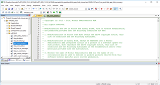

and trying to compile but there is an error durring linkage phase,
Linkage nrf_init:
undefined symbol ble_conn_params_init
so my guess is that I need some binary file to pass this to linker because this is not compilation error meaning headers are fine but I'm missing library function. So my question is what should I do?

I think I get it, there is no such thing like binary file of the library, everything I need from this libary I should compile manually. Am I right?
