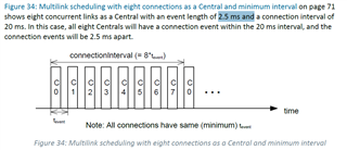

    NRF_SDH_BLE_GAP_EVENT_LENGTH on central is 2 (2.5ms). Thus Central is able to process requests from all three peripherals within one connection interval. Right?
    I am testing at home where only WiFi can interference.
    I have bought ANT060, but it appeared that NRF52840 DVK has SWF connector instead of UFL on antenna. Is it possible to de-solder SWF and solder UFL instead?
     Yes, this is correct. See the softdevice specifications for the S140 v6.1 softdevice here (pg 71):
