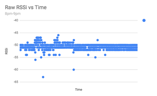

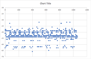

i have start my project in NRF52-DK development kit  but some BLE card give me data in three channel and i have received all data and give me same like data pls find photo.
and i have mask my other channel 38 and 39  and this give that type data pls find photo is only 37 number channel so this is mask my channel 38 and 39 ????
i have not conform so pls help me.

    Right now i am able to get the scanning channel index...
    but method  i am using for channel masking is may be wrong...becuse every time i got the data from all the channel...there is no effect of masking the channels.

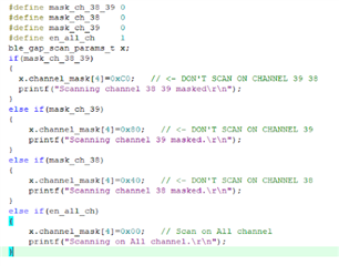

  • There is Struture ble_gap_scan_params_t in ble_gap.h file  and that struture has member like interval, window timeout and channel_mask.
    In the main file i create a variable/instance or object (ble_gap_scan_params_t x; as shown in imgade send by nirav)and access the struture varible called channel_mask using       x.channel_mask[4]=0x80;
    and set this values before scan_init() function called in main function.
    but still scan result comming from all channel.
    is this correct method or wrong one.??
  • Have you set the channel mask of the m_scan_params you use in sd_ble_gap_scan_start(&m_scan_params, &m_scan_buffer)?
