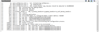

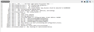

I want to implement mesh functionality. There is no problem with nrf52dk board, but I think there is a problem with board that I made with nrf52832 chip. attach the photo. Please see what's wrong. light_switch_provisioner Example.
Did you erase the flash before programming the light switch provisioner example and the Softdevice? Data stored from previously might interfere with the mesh stack operation and cause asserts.
--Marjeris
I did it in the way you told me. The error has disappeared. But can not scan. Could you tell me why? Is there a difference between starting with segger 6 and starting with segger 2?
Do you see the board scanning for devices to be provisioned in debug mode? It should look like this:
In Debug mode, there is no board scanning for devices to be provisioned. Could you tell me why?
But in the screenshot you sent me the board had started to scan for unprovisioned devices, so it seems like everything is working fine. Do you have any unprovisioned devices up and running in another DK? For example the light switch client and server examples?
