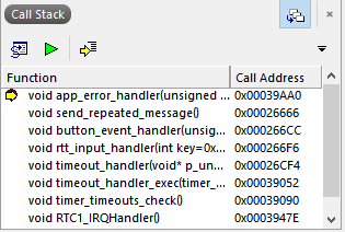

    I also tried a different approach and set a breakpoint at the app_error_handler() function instead, so I could try to catch what function was return the error, but without success. The function that is shown before the app_error_handler() in the Call Stack is the function I created myself to send the messages:

  • The messages will be stored in a buffer, and will be sent out when the Mesh is available. So if you send a lot of messages fast, the buffer will be filled up and you will get NRF_ERROR_NO_MEM.
    I can see that you are using nrf_delay_ms(100); when sending the messages. This can cause a lot of issues and isn't recommended. By using nrf_delay_ms() you will hold up the CPU from doing anything. If you want to use a timer, you can instead use app_timer.
    You can use the tx_complete event to send messages consecutively. That way you won't fill up the buffer.
