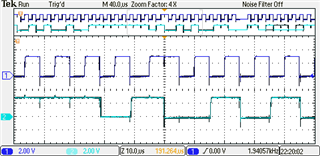

I am currently building I2C communication between nrf52832 and a stm32 chip, stm32 as the master and nrf52 as the slave.
The situation is the stm32 couldn't get the data from the nrf52 but I can actually the data flowing through the SDA channel via the oscilloscope.
When I change the slave to another sensor with I2C, the stm32 can receive the data from the sensor so I guess my stm32 code is good and the problem might be in the code of the nrf52.
But another weird thing is, when I use the arduino as the master and nrf52 as the slave, the arduino can receive the data from the nrf52.
I really have no idea what is wrong. Any suggestion would help.
Thanks in advance,
Duncan
Here is code for the nrf52 and the image from the oscilloscope.

From the oscilloscope, I can see the stm32 sent the start condition, stop condition, the slave address, the write or read command; the nrf52 sent the ACK to appropriate positions and data.
