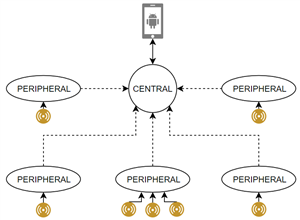

I am in the process of determining a system architecture for a sensor-bluetooth-android application. The goal is to read sensor information from an Android device, using ble and several sensors as the embedded part of the project.
The sensors will be connected to nrf52832 modules. Various elements will be measured so the communication between sensors and ble modules will be in several ways (SPI, I2C, analog readings).
As of right now, there is a working setup where several sensors are attached to a nrf52 module and their readings are transmitted through advertising packets to the Android application The limitation of this way is the number of bytes that can be sent per advertisement and attaching several sensors to one small battery is resource hungry and will not satisfy the capacity vs. time requirements.
I have been thinking of doing it like on the attached image:
In this way, the sensors could be powered from different coin cell batteries of their peripherals. The peripherals would send their data to the central BLE node and that node will be set up to have a connection with the Android device.
  1. Is this possible to do and which examples should I look into?
  2. How should peripherals talk to the central? Should they be connected, or do some kind of directed advertising?
  3. What would be the limitations of the data transmission between the central and android device? I have came to understand that the advertising package is limited to 31 bytes (usable is 20 something). How limited would it be to transmit data in such way?
  4. Would it be possible to send a command to the central to put all devices to sleep, until connection is initiated again?
  5. It would be possible to set-up all peripherals as advertisers and filter the results on the android phone - what do you think about that?
I will be grateful if you could offer some useful links and thoughts about the idea - especially keywords and topics what I should research according to the latest capabilities of SDK15+. I will start researching the pros and cons in the next couple of days and the aim would be to determine key focus points in such a connection setup.
  • The thing you've marked "Central" will also have to be a Peripheral for the phone connection.
    Why do you need a separate "Central"? Why not just have the phone query your peripherals directly?
  • Your phone is the central already.  You can scan multiple peripheral devices with it, no need of a separate central.  Second solution, you can also advertising by alternating sensors using advertisement timeout.  Each time advertisement is timeout, you re-advertise a different sensor.  Include in your advertisement packet an ID number to identify which sensor is advertising.
  • Thank you for clarifying the central/peripheral state.
    The reason why I consider a connectable connection between the phone and the "common/central beacon" is that the whole sensor system illustrated on the image is one closed system, it will be used for one application.
    What is there would be two of these "applications" close together or ten of these sensor networks in one area and 3 android devices walking around, trying to decide to which one of the "applications" to connect to? How could I sort/filter the applications/sensors on that case?

    What about still having a centralized beacon, that collects data from surrounding beacons in intervals and at the same time transmits that data forward to the android phone? Do you see merit in this?
  • I am not sure to understand what you want to do.  I assume Application 1 = phone 1, Application 2 = phone 2.  All the phone will receive the advertisement data from the peripheral without any connecting to it.  The phone knows from which device the adv data came from.  The peripheral on the other hand knows nothing about the phone.  The peripheral cannot initiate a connection neither.  It is a slave device.
