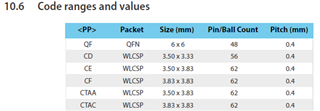

Hi I would like to confirm which NRF51822 models are the 0.35mm thin WLSCP package. I checked Avnet distributor and they say that NRF51822-CTAC-R7 is 0.35mm but the package says 48-Pin QFN. Can someone please clarify? Thank you.
Straight from page 76 of the product spec. Looks like Avnet has a mistake in their listing.
