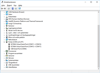

    I should be very surprised if it vere the wrong port. COM3 if the FTDI cable, something I have verified more than once using the ..\examples\peripheral\uart\pca10056\blank\ses and not forgetting the new bootloader which, for various reasons, can not use digital signalling to enter DFU-mode. We will use a command over the UART, which works perfectly well by now. The bootloader functionality unfortunately does not.
    What is the JLink CDC UART Port? I have never heard of this before. Isn't it just another COM port that is used by the nrfutil? In the real application we will have a gateway (Sierra Wireless FX30) and an add on card (with nRF52840) connected through the serial port. We have neither room nor economy for additional hardware!

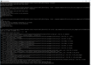

    For some unknown reason I am not allowed to make a reply to your latest post, so I do it here instead.
    As you can see from the image below it did not quite work as intended...
    As you pointed out, the new hardware did nothing to improve the situation but at least we have verified that which is good.
    What do we do now?

  • Hi.
    Did you try to do as i said in my previous reply? That is open the project found in examples\dfu\secure_bootloader\pca10056_uart_debug, edit sdk_config.h inside the project, edit dfu_public_key.c inside the project, create a .bat file and paste the code i posted in my previous reply.
    Because it seems from the screenshot you sent that you did not program using that .bat file, and you are still programming the  nRF5_SDK_15.0.0_a53641a\examples\dfu\secure_dfu_test_images\uart\nrf52840 examples.
    I've attached it in this reply.

    Must have sent the wrong picture, sorry for that. It did not work nevertheless.
    However, I have ditched the nrfutil that came using "pip install nrfutil" and downloaded a precompiled version which most likely is exactly the same as the one I used initially.
    This time it actually worked. I have even made som progress on the bootloader for the custom board. I have come to the conclusion that you need to set the "--sd-req" to an unsupported value for the download to work properly. This is as far as I can remember not mentioned anywhere in the documentation, which I for obvious reasons have not read in it's entirety.
