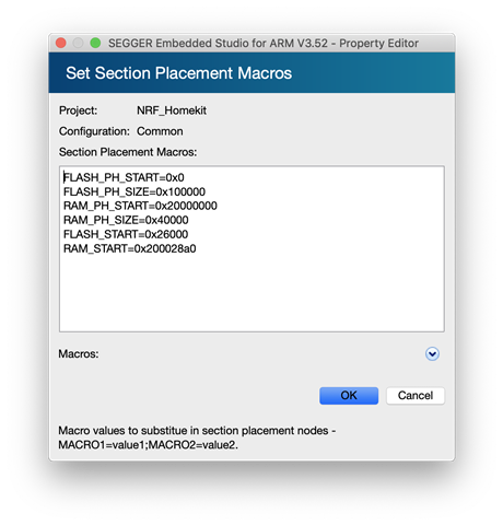

I've got a NRF52840-DK development kit and tried to configure it with a ATT MTU size of 512 bytes (larger than 247 bytes). I've activated data length extension and configured the BLE softdevice with the following code:

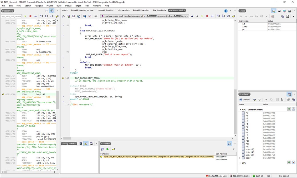

When I enter 247 as the size for the ATT MTU all works perfect, but when I choose a larger number (in my case 512 byte) as ATT MTU, sd_ble_enable() does not return an error and I can debug over the code line. But when I try to step over the APP_ERROR_CHECK, it stops at the assembler command "4B01 ldr r3, [pc, #4]". When I debug through the assembler commands it ends after the command "4798 blx r3" with a NRF_BREAKPOINT_COND. What can I do to use a ATT MTU size over 247 bytes?
