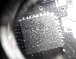

I want to set up nrf24le1 in register retention mode with analog comparator wake up. The moment it wakes up it should do few ADC conversions and then again go back to sleep. I could not find much information on this or any example code. I just found this:
hal_ancmp_set_input_channel(8);//P1.0
hal_ancmp_set_ref_voltage_scale(0x01);//50%
hal_ancmp_set_reference(0);
hal_ancmp_enable(true);
PWRDWN=0x04
from this thread here: https://devzone.nordicsemi.com/f/nordic-q-a/20741/how-to-wakeup-with-analogcomparator-on-nrf24le1
But I do not know how that code works or how to change it to do ADC conversions on wake up and then go back to power saving mode. Someone please help.

    Now for this to wake up I give 3V to pin P1.0 but nothing happens after that.It does not wake up and does not enter into the while loop?

  • And you are running the code I sent with no modifications on an nRF24LE1 dk module? What package variant?
    Kenneth
  • I disabled RTC code and ran,dint work. I enabled RTC code and ran again it dint work. Power consumption of the chip in both these attempts was never 0.002mA as per the data sheet.It was 4.2mA or 1.2mA with lower clock of 125Khz
  • Package is 32 pin variant,as you can see in the picture that I posted.
