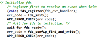

Updating existing record with fds_record_update fails SDK 15.2
How can I find out, what the reason is for error 173495(decimal) in function fds_record_update()?

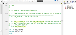

Preprocessor Definition is set to DEBUG.
    173495 is an invalid return value. The log also indicates that you have a softdevice assert, not an assertion in your code. Please verify that  fds is configured to use nrf_fstorage_sd as backend in your sdk_config.h file. I.e., FDS_BACKEND == 2.
  • Hi Vidar,
    I checked sdk_config.h and FDS_BACKEND is set to 2.

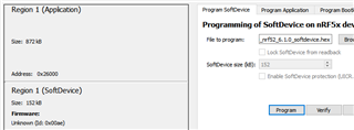

    In the meantime I erased the board in nRFGo Studio and reloaded the Softdevice and the application(modified Blinky + FDS functions).
    Now the program tries to create the first configuration file and fails.
    I am convinced that these errors are related to the fds_record_write() and fds_record_update() function.
    I encreased the config dummy structure to save in flash and must have done something wrong and I need to correct that.

    One more question. Do you see any problems with the following sequence: initialize fds, initialize serial, update fds config record in main.c ?
    // Initialize fds
        /* Register first to receive an event when initialization is complete. */
        (void) fds_register(fds_evt_handler);
        err_code = fds_init();
        /* Wait for fds to initialize. */
        wait_for_fds_ready();
        err_code = fds_config_find_and_write();
    // Initialize serial
        err_code = nrf_serial_init(&serial_uart, &m_uart0_drv_config, &serial_config);
    // update fds config record
    err_code = fds_config_find_and_update();
    Thank you.
  • Glad that it works now. I don't see any problems with the startup sequence you mentioned.
