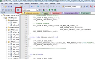

  • Hi Torbjørn,
    1. My project is '.\nRF5_SDK_15.2.0_9412b96\examples\proprietary_rf\NordicCode\ptx\pca10040\blank\arm5_no_packs\esb_ptx_pca10040.uvprojx".
    2. About the problem of UART, UART can print debug message after I modify NRF_LOG_BACKEND_UART_TX_PIN define. Thank you,
    And I found some strange problem:
    1. After I download the binary code by press "load" button (please found following screen), the UART can not print any Debug message.
        Does it means the program doesn't execute?
    2. If I use"start / stop debug session" to execute in debug session ans exit then exit it (please find following screen",
        then the UART will start to print debug message.
    Wound you please tell me what the different between "direct download code into nRF52832 device" and "execute code in debug session mode"?
    Thank you,
    Chianglin
  • Hi Chianglin
    1. My bad. It seems the project didn't include the right header files, even though I changed the project settings. This should be corrected now:
    esb_template_app_timer_v2.zip
    2. Could you try to press the IF BOOT/RESET button on your DK after flashing from Keil?
    It is possible that it is not working because the chip is not being reset after the download.
    Best regards
    Torbjørn
  • Hi Torbjørn,
    Sorry for reply so late. Thank you for your kindly answer.
    I know the reason why nrf52832 device can not auto reset, it is because my segger JTAG interface is damaged.
