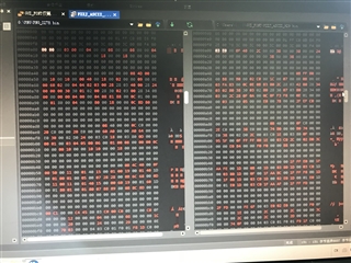

Hi :
I find  some  problem about thGUI_FONT.rar.
First I connect the USB,then I copy a folder with 18 binary files to my 52840DK,then reconnect.and compare the folders in DK with the original folder in my PC,I find out the data of a binary file(FZZJ_ASCII_H29.bin) is differnet with the orignial data.Everytime I try the same file is wrong,but the others are right,I also try to copy the FZZJ_ASCII_H29.bin alone,and the data is  wrong too.Is there anything I should pay attention to about the file? I don't understand why dose the  wrong data issue appear only at the one binary file.
