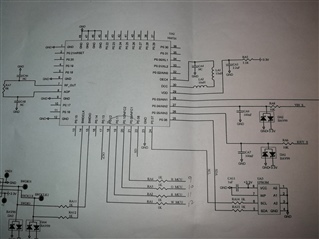

How I can control Pin0.8 Pin0.9 as PWM Channel to output PWM wave I want?
I reference demo1 of PWM driver example in SDK15.2.0, I make myself PWM driver. the official demo1 use pin17-20 as PWM channal1-channel4, but I use Pin9-P12, I modify the config file, like follow
//official configure

//my configure
#define LED_START 9
#define LED_1 9
#define LED_2 10
#define LED_3 11
#define LED_4 12
#define LED_STOP 12

when I run the new image file on nrf52832 on my board(different to Pca10040), I find the Pin10 and Pin12 can output the PWM I want, But Pin9 and Pin10 do nothing, This makes me confused, I believe Pin9 and P10 are less different than Pin11 and Pin12, but why Pin9 and Pin10 don't output PWM I want. How I fix this issue?
  • Can you please post some of your code?  By default pin 9 and 10 and used by the NFC peripheral you need to define CONFIG_NFCT_PINS_AS_GPIOS in your project settings or makefile to get them to be GPIOs.
  • Pins 9 and 10 actually default to NFC pins, so must be reverted to i/o pins before they will be useful on your design. Typically you can do this by defining CONFIG_NFCT_PINS_AS_GPIOS in your project options; this code in system_nrf52.c then puts the pins into the i/o mode.

  • thank guys, the reason just is that. I already control the PINS.
