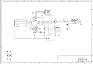

I'm developing a custom board that is equipped with a nRF24L01+ (directly soldered on my PCB, no breakout). The board is equipped with a PIC32, that controls also the nRF. I'm writing a driver to do that, since there is a posix-like osal that run on the PIC.
Before going into details, these are the nRF connections:
Please note: currently L1, L2 and L3 are NOT mounted, since there are some problems with the external antenna tuneing. May this be a problem when writing/reading registers?

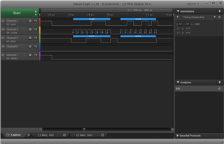

So, I'm trying to interface with the chip via SPI, but when I write a register and read it back, I got inconsisten value:
Here I previously wrote 0x25 to DYNPD (0x1C) register, and when I try to read it back I got a different value, 0xC5.There is a delay of 5mS between write and read.

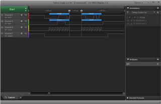

Now the fun part: when I try to do the same operation with Arduino, on the same board (also with a commercial brekout), I manage to get the wrote value:
I tried with different SPI speed (1/2/4/6/10 MHz) but the result won't change.
